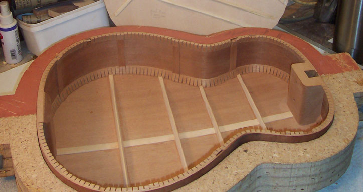

One more thing; the side braces are a few millimeters shorter than the height of the sides. That way, should the sides shrink with humidity, the braces will hopefully not push the plates out.
Here's an old picture:
